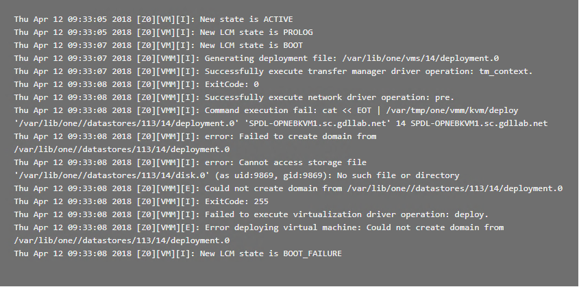

Error: Failed to create domain from
I am getting the following error while deploying the VM:
What is it related to exactly?

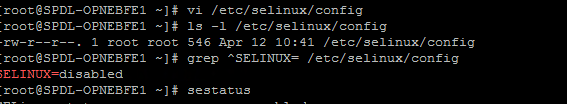

I get a different one now. Is it related to datastore? How do I check my DS are working properly?
Are you sure you’ve followed the installation guide?
Looks like you’ve missed at least Step 3. Disable SElinux in CentOS/RHEL 7.
I’d recommend walking through the entire installation and check is everything Ok.
Best Regards,
Anton Todorov
I have disabled SELINUX on all the server but it shows enforcing:
Quoting the last line in the above link:
“After this file is changed reboot the machine.”
It’ll be hard to name it Security Enhanced linux if it is so trivial to completely disable :wink:
BR,
Anton Todorov
