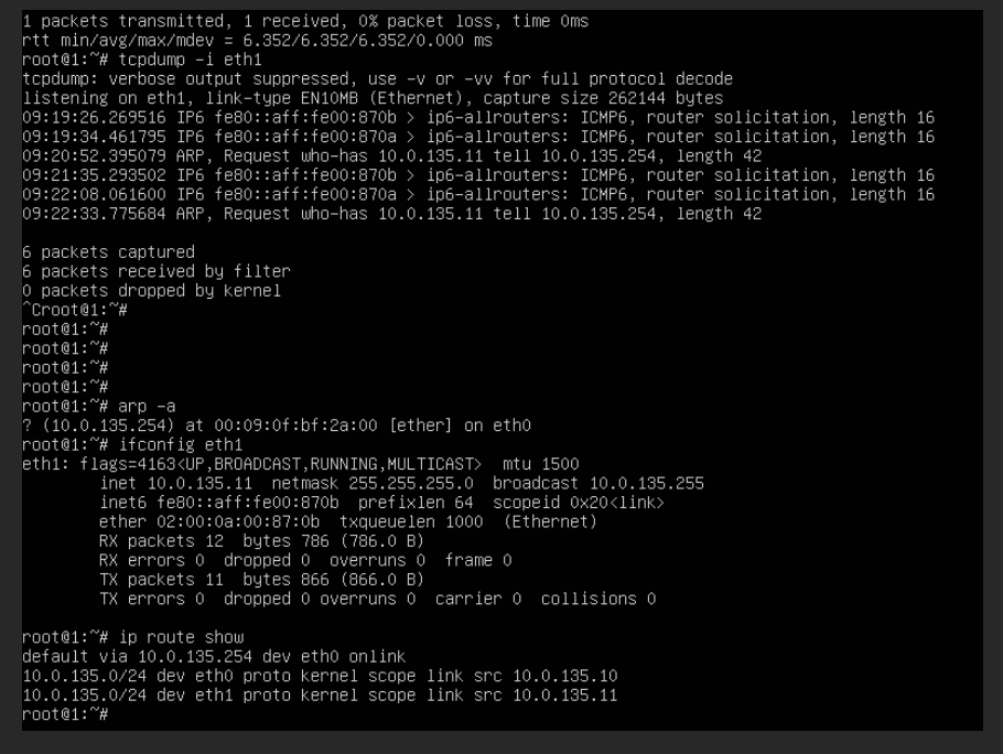

Hello, ok so after having a look I have replicated what you have said.
I setup a VM using a network VLAN 135
This had an address 10.0.135.0/24 [10 - 200]
I attached two NIC’s to the VM
eth0 - 10.0.135.10/24
eth1 - 10.0.135.11/24
These both had gateway’s set via context so when I boot my routes are as follows:
ip route show
default via 10.0.135.254 eth0
If I shut down eth0 it also removes the default gateway which messes things up I have to then add manually.
Anyway if I try access eth1 IP I can’t, if I try ping from the L3 in front of the VM I can no response put can see the traffic on tcpdump.
If I check arp I can see that eth0 MAC is responding with eth1 IP address (probably because of default gateway)
i checked proxy_arp and its off by default.
which it shouldnt need on but is behaving like proxy arp.
Anyway it looks like the original ethernet adapter is answering to arp for both IP addresses.
This is then failing anti-spoofing as the traffic is originating from the eth0 which has anti-spoofing on 10.0.135.10
as soon as I disable anti-spoofing it works fine (Just as you have said).
Please see bellow:

PBC-FW01 (root) # get system arp | grep 10.0.135.11
10.0.135.11 0 02:00:0a:00:87:0a VLAN-135
10.0.135.10 0 02:00:0a:00:87:0a VLAN-135
^^ mac is the Same suggesting it is coming from eth0
