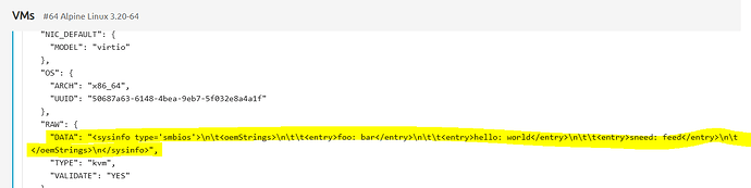

  "RAW": {
    "DATA": "<sysinfo type='smbios'>\n  <oemStrings>\n    <entry>foo: bar</entry>\n    <entry>hello: world</entry>\n    <entry>sneed: feed</entry>\n  </oemStrings>\n</sysinfo>",
    "TYPE": "kvm",
    "VALIDATE": "YES"
  "SCHED_REQUIREMENTS": "HYPERVISOR=kvm"
Upon instantiating the vm, and checking dmidecode –type 11 , i dont see the oemstring that i have set in the template.
Also another thing i noticed, upon instantiating the vm, i dont see the information ive conigured in the vm template reflecting on the curren vm configuration as seen here
Thoughts on what possibly is the mistake here? Thanks in advance!

Hi Anton, heres’s the contents of the “deployment.0” file
This does not match the RAW section from the previous comment. Some consistency in the comments will help.
For example, the following piece in the the VM xml:
    <oemStrings>
      <entry>foo:bar</entry>
      <entry>second: spaced</entry>
      <entry>third:value</entry>
    </oemStrings>
  </sysinfo>

Please show your VM Template contents with onevm show <vm_template_id>. Ideally use a 7.0 instead of devel 6.99.
Hello,
Here the output of the onetemplate command
oneadmin@vm-openneb-v7:~/datastores/0/63$ onetemplate list
  ID USER     GROUP    NAME                                                                                                                                                                              REGTIME
   2 oneadmin oneadmin Debian 12                                                                                                                                                                  07/20 12:26:11
   1 oneadmin oneadmin Service Virtual Router                                                                                                                                                     07/09 13:48:45
   0 oneadmin oneadmin Alpine Linux 3.20                                                                                                                                                          07/02 07:00:18
oneadmin@vm-openneb-v7:~/datastores/0/63$ onetemplate show 0
TEMPLATE 0 INFORMATION
NAME           : Alpine Linux 3.20
USER           : oneadmin
GROUP          : oneadmin
LOCK           : None
REGISTER TIME  : 07/02 07:00:18
OWNER          : um-
GROUP          : ---
OTHER          : ---
TEMPLATE CONTENTS
CONTEXT=[
  NETWORK="YES",
  PASSWORD="OgCVPM6rmNBt/2PmmFCpcQ==",
  REPORT_READY="NO",
  SET_HOSTNAME="$NAME",
  SSH_PUBLIC_KEY="$USER[SSH_PUBLIC_KEY]",
  TOKEN="NO",
  USERNAME="admin" ]
CPU="1"
DISK=[
  IMAGE_ID="0" ]
FEATURES=[
  GUEST_AGENT="yes" ]
GRAPHICS=[
  LISTEN="0.0.0.0",
  TYPE="vnc" ]
HYPERVISOR="kvm"
LOGO="images/logos/linux.png"
LXD_SECURITY_PRIVILEGED="true"
MEMORY="256"
NIC=[
  NETWORK="public_vnet",
  NETWORK_ID="4",
  NETWORK_UID="0",
  NETWORK_UNAME="oneadmin" ]
NIC_DEFAULT=[
  MODEL="virtio" ]
OS=[
  ARCH="x86_64" ]
RAW=[
  DATA="<sysinfo type='smbios'>
        <oemStrings>
        </oemStrings>
</sysinfo>",
  TYPE="kvm",
  VALIDATE="YES" ]
SCHED_REQUIREMENTS="HYPERVISOR=kvm"
And heres something from the onevm show

While looking into this I found a bug related to the web interface where it swallows the whole RAW section, exactly as you seem to have. Since you showcase a picture of FireEdge Sunstone in your initial report, this is likely what is happening to you. Please use the CLI and check if your RAW as Anton suggested appears.
Thank you for the information! I tried instantiating the vm through the cli and i could now see the RAW data being passed.
        <oemStrings>
        </oemStrings>
</sysinfo>
        <metadata>
                <one:vm xmlns:one="http://opennebula.org/xmlns/libvirt/1.0">
                        <one:system_datastore><![CDATA[/var/lib/one//datastores/0/64]]></one:system_datastore>
                        <one:name><![CDATA[Alpine Linux 3.20-64]]></one:name>
                        <one:uname><![CDATA[oneadmin]]></one:uname>
                        <one:uid>0</one:uid>
                        <one:gname><![CDATA[oneadmin]]></one:gname>
                        <one:gid>0</one:gid>
                        <one:opennebula_version>6.99.90</one:opennebula_version>
                        <one:stime>1755536877</one:stime>
                        <one:deployment_time>1755536884</one:deployment_time>
                </one:vm>
        </metadata>
</domain>
However, dmidecode doesn’t really show the that i tried to pass. i expect it would show up when running dmidecode --type 11 but unfortunately i dont see it.
