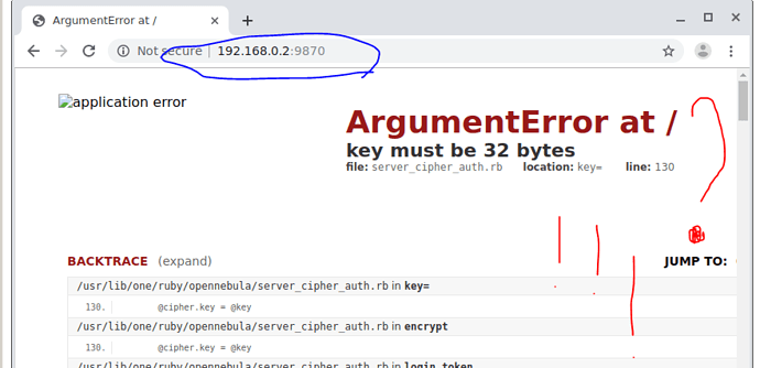

When I correct in sunstone settings:
It - image
On this( Server address where sunstone is located) - image
Here is what we observe:
Telnet -
Http !!! Connection does not drop but -
I don’t understand anything … On the server, besides ON, there is nothing, the installation was done by the instruction - http://docs.opennebula.org/5.8/deployment/opennebula_installation/frontend_installation.html … Several times it has already been creating sevrer - ON …
I would be grateful for the help.
Do you see any error on the browser console?
I did not understand the question.
If I don’t get the hosts address in sunstone.cfg, then I get an error - refuse connection.
If I check on the IP address of the server where the sunstone is located, then the web page opens with an error, as in the picture above …
