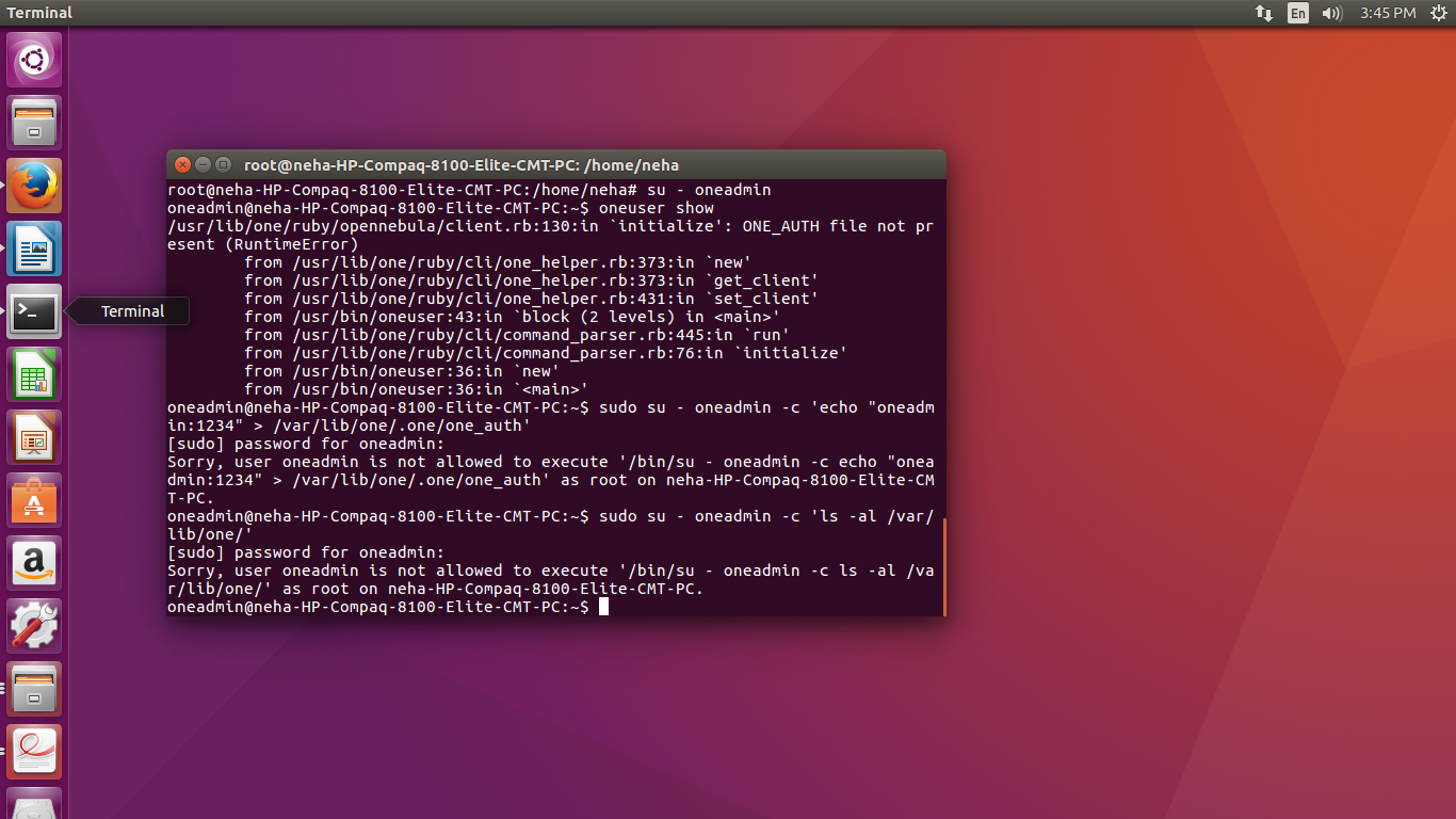

Even I am unable to get the root privileges in oneadmin account. Authentication failure message occured. Please help me what should I do?

The whole /var/lib/one must be owned by oneadmin user, including subdirectories and hidden files.
I have removed the added line from /etc/sudoers file and issued the commands suggested by you. Again I am getting below error.
Sorry, user oneadmin is not allowed to execute ‘/bin/su - oneadmin -c ls -al /var/lib/one/’ as root on neha-HP-Compaq-8100-Elite-CMT-PC.
The output is attached.
The main problem is /var/lib/one is not accessible by oneadmin.
Have you executed:
[neha@neha-HP-Compaq-8100-Elite-CMT-PC ~]$ sudo su - -c ‘chown -R oneadmin.oneadmin /var/lib/one/’
