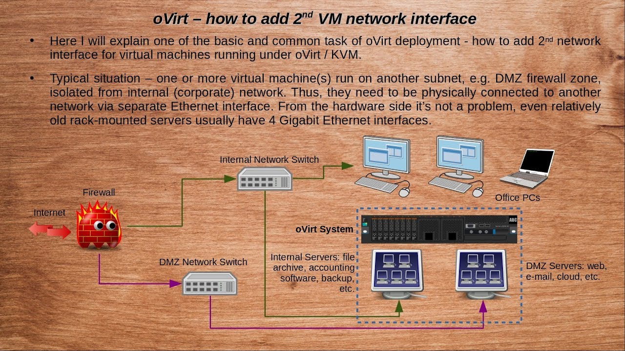

I’m going to make a tutorial video - migrating private VM cluster (small-medium company, 10 - 50 VMs) from oVirt to Open Nebula.
If anyone from Open Nebula dev team is interested I can give early access on our NextCloud to check if everything is OK, something to correct, add, etc.
Examples of my old oVirt tutorials can be seen here:
