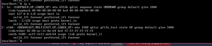

I created an alpine vm and tried setting static and dhcp IP. However no IP is assigned. using one v7 See Below

An IP is assigned by opennebula - see screenshot below, howeverip a` does not show the IP assigned.
Static IP works fine.
For OpenNebula to set up the network by default, you need to set Context → Method as none (Use default). Setting it up to dhcp means that you have a DHCP server on the same Virtual Network (i.e., on a 802.1q network segment).
OpenNebula does not use a DHCP server inside, the contextualization sets up the network automatically.
