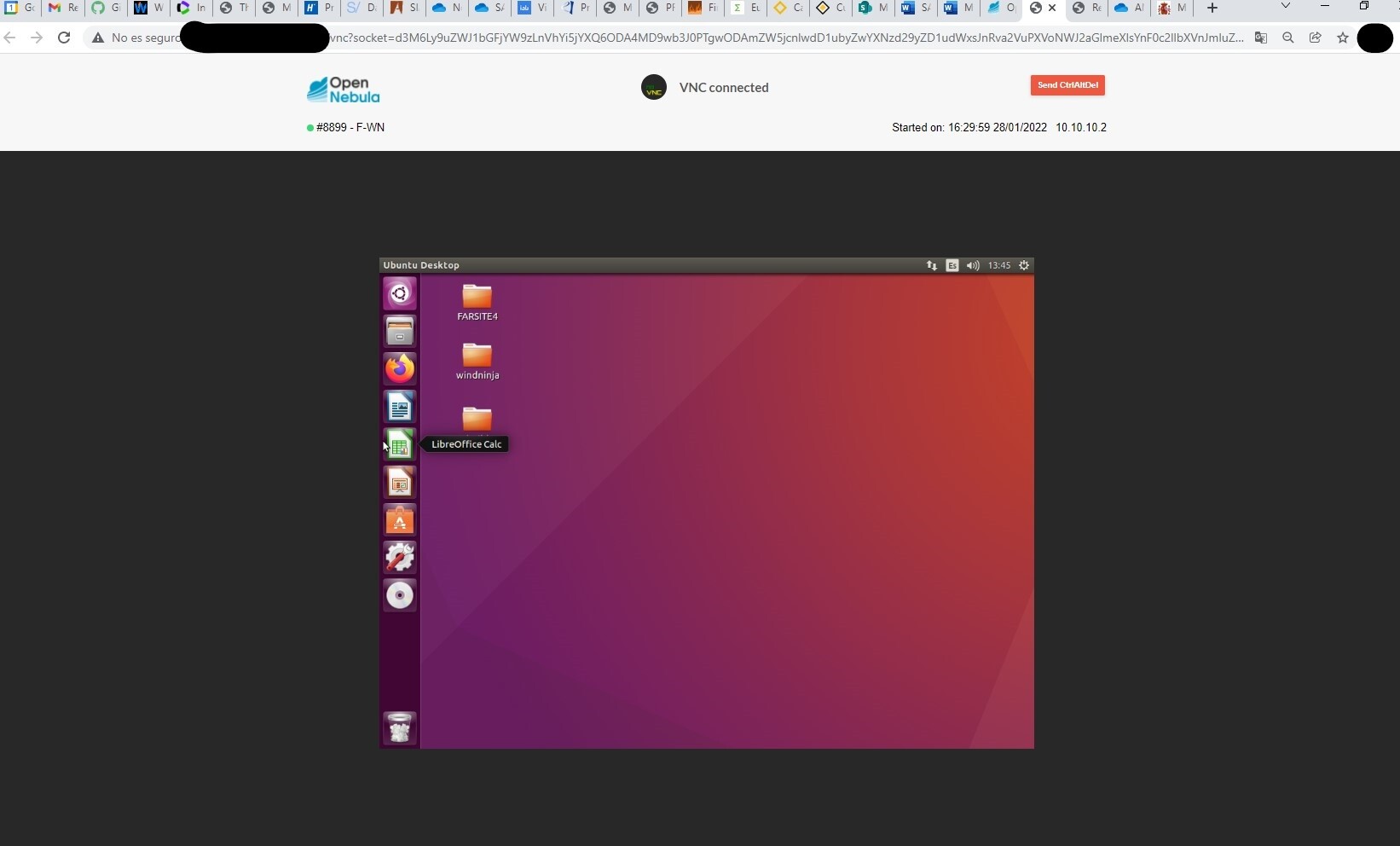

I’m doing some test with three screens (laptop, one TFT and a wacom tablet) and I have found this problem:
  • when I open a VNC session from an instance, its size depends on what screen I’m seeing that. By this reason, I get a good resolution in laptop and Wacom, but not in monitor.
  • In the same way, when I drag-and-drop VNC tab between my screens, the white frame (when we can see instance number, started time, etc) resizes too, so in my laptop is smaller than in TFT and Wacom
I attach three screenshots where you could see what I’m explaining:
  • from laptop:
  • from TFT:
  • from Wacom:
