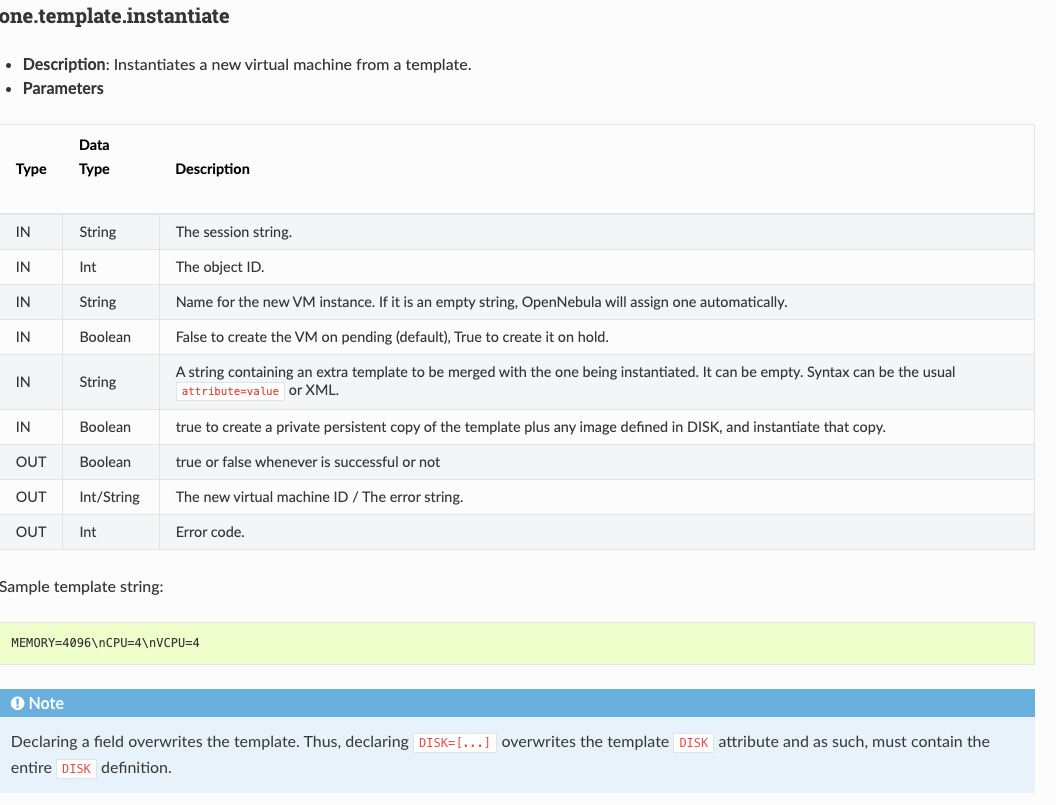

For example this the documentation about instantiating VM via a template:
It does NOT display what the parameters for the XML template should be.
Should I be looking some where else and can you please point me to the place.
A VM Template can be very simple or very complex, it doesn’t have a parameter list, the VM Template itself is the parameter to the call. Regarding what it should have or not, depends on the VM you want to create. There are some mandatory attributes, like memory and cpu. You can also take a look at the vm template schema for details.
